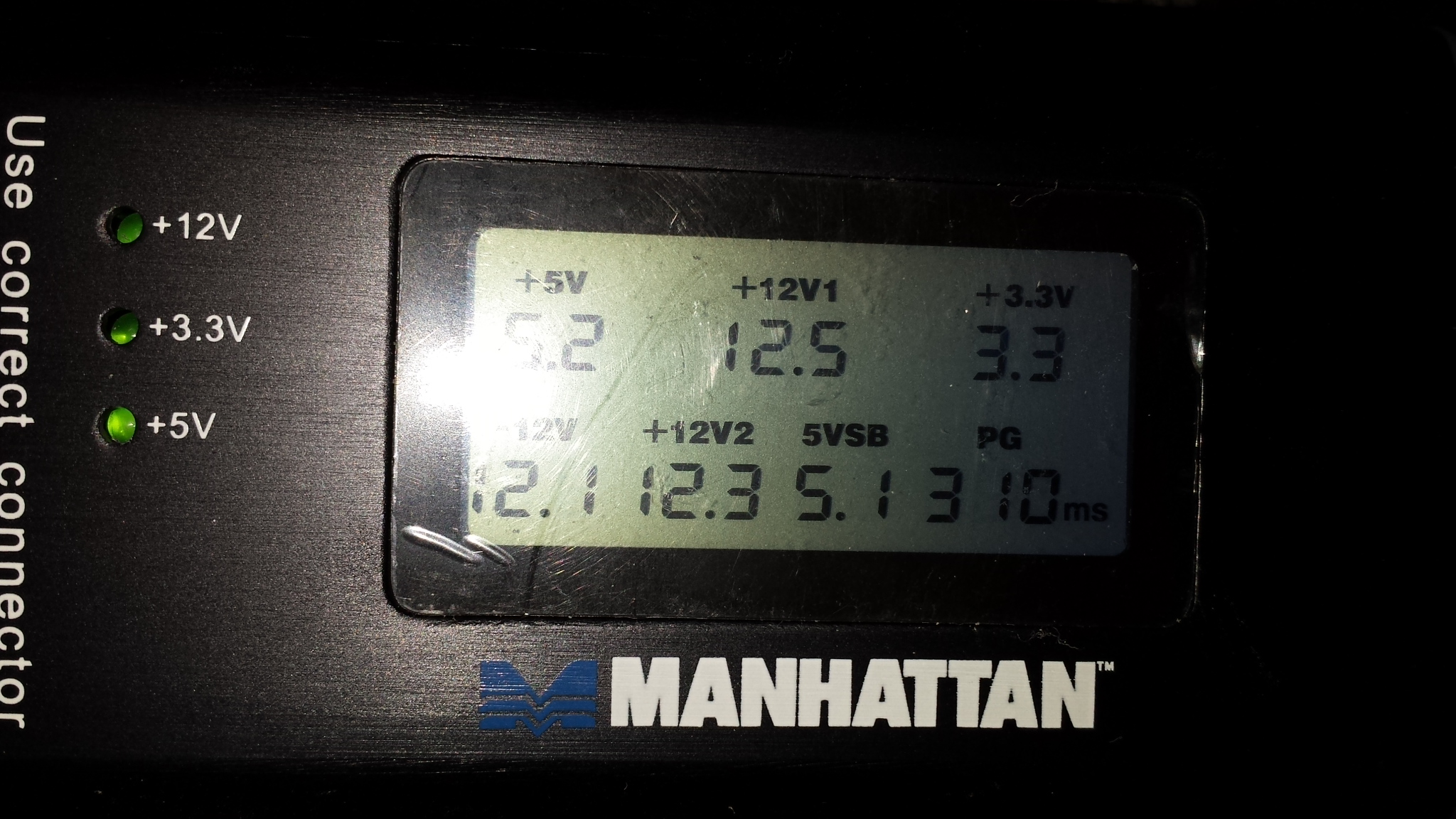

    • #1473111
      I ordered a PSU tester today from amazon http://www.amazon.com/Sanhattan-Products-Digital-Supply-Tester/dp/B0016MHQA8/ref=sr_1_17?s=pc&ie=UTF8&qid=1414680219&sr=1-17&keywords=power+supply+tester
      It cost a little more than the one you posted Coochin but the reviews were excellent. I’ll probably receive it long before I receive the MB combo.

    • #1473290
      All this discussion about a ps tester is well and good for a quick test but a device like that does not test power quality: just because it tests good on this device does NOT mean the ps is good. If it tests bad I’ll go with bad. Test the ps under load peripherals connected, don’t make it easy on the ps 😡
      My personal preference would be a decent cheap multi-meter if you have a steady hand.
      Swaptronics would be best :wub: :coffeetime:
      • #1473313
        Actually, wavy, I do happen to have a very good-quality multimeter and often use it to test various other computer components’ voltages or other similar values.
        As for “…a device like that does not test power quality…” is quite mistaken; the whole point of using a simple PSU tester is to test power quality.
        And “…just because it tests good on this device does NOT mean the ps is good…” I don’t dispute. There have been some few occasions when I have tested a PSU with my “EZ” tester when it later turned out that the PSU was faulty after all. I use the “EZ” tester because it is a quick and reasonably accurate test of a PSU. If I were to fiddle-faddle around with a multimeter in the same circumstance spending a considerable amount of extra time the customer is likely (and understandably) to become upset as to wasted time.

    • #1473560
      Results from PS tester w/ 24 pin & 8 pin connections plugged in:
      38333-20141101_185313
      • #1473607
        Results from PS tester w/ 24 pin & 8 pin connections plugged in…
        Those readings are all good (pretty much what I expect to see whenever I test a decent PSU).

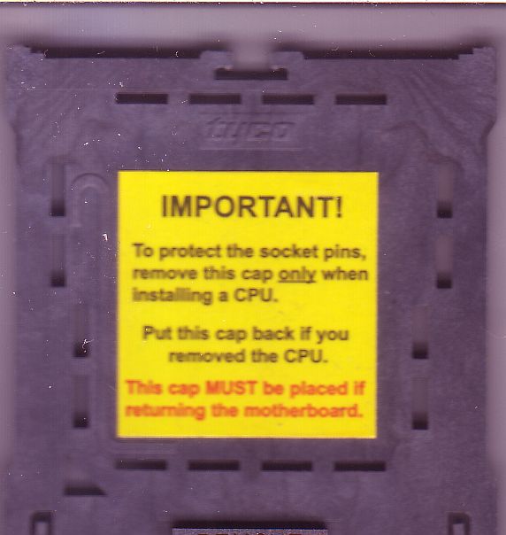

        In your #50 post you stated you ordered a motherboard online. If you talk with your supplier they might (read “should”) let you return just the motherboard for warranty.
        But there are a couple of catches:
        (a) You would need to package the motherboard to avoid damage during shipping (plastic “bubble-wrap” or wrap in corrugated cardboard and in a suitable carton), and
        (b) Make sure the CPU slot is “capped” (your supplier should be able to mail you one of these caps). See below scan of an Intel CPU slot cap:
        38337-CPU_cap
    • #1473590
      Yes, well, throughout all of this I have not thought the P/S was @ fault. Slight possibility, maybe, but, very unlikely.
      Cheers,
      Drew
      I agree but it’s nice to know that the PS is ok. Still think it’s the MB.
