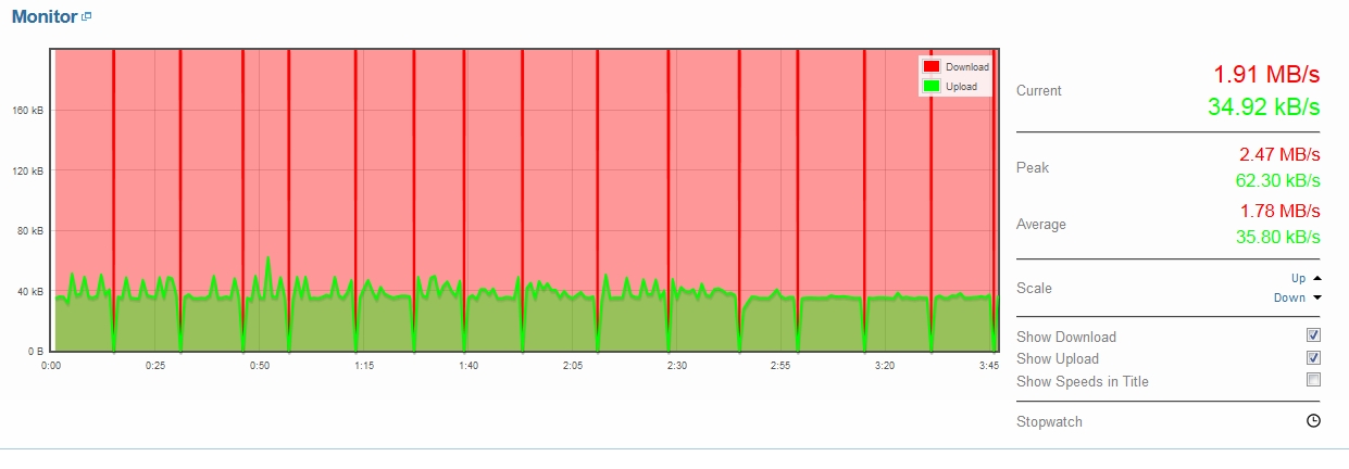

            First, I am using DSL connection on the Billion modem/router, from the phone line, through the splitter from the wall-socket.
            The download speed (1.7Mbps) I gave are from the wired connection to my computer. I am not worried about the wireless connection at this times as I rarely use WiFi.
            Here is the result of the BT Wholesale test you suggested:
            44215-speed-test-1
            Here also is an image of downloading Ubuntu ISO file as a torrent download.
            44216-download
            Here also is an image of Ubuntu being downloaded directly from the website.
            44217-web-download
            The speeds are the same and consistent in either case – always, at any time. The same speeds also come out the same for other downloads, though some can be slower, never faster. The ceiling is always the same.
            I expect, as you say, the speed will increase as the BT line profile adjusts over the next 10 days or so.

              Thanks for clarifying. The Billion is an ADSL2+ device capable of a theoretical 21-24 Mbps connection from ISP to you… on a sunny day and if your house was next door to the local telephone exchange.
              Your BT profile shows a theoretical connection speed of 15.05 Mbps, i.e. assuming all phone cabling is in top-notch condition and taking the distance from the local telephone exchange into account. The BT profile also shows that you’re actually getting a download speed of 14.59 Mbps from the local telephone exchange to your house during the test. In my opinion this is still a respectable speed for the type of service.
              Your PC is connected to the Billion using an ethernet cable (not wireless) so, depending on the capability of your PC’s NIC, the quality/CAT rating of your ethernet cable and whether it’s connected to the Gigabit port on the Billion, the connection speed between the Billion and PC is either 10, 100 or 1000 Mbps.
              Your torrent download shows a download speed of 1.7 MB/s (not Mbps). Plugging this into a converter equates this to 13.6 Mbps… fairly close to the 14.6 Mbps shown during the BT profile test.
              44220-MB-to-Mbps
              Click to enlarge
              From this you can tell 2 things:
              1) Your PC’s NIC is not operating at just 10 Mbps.
              2) BT doesn’t appear to be throttling your P2P connection.

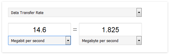

              Looking at it the other way…the BT profile test shows a ‘best’ of 14.6 Mbps. Plugging it into the converter again shows that this equates to 1.825 MB/s.
              44221-Mbps-to-MB
              Click to enlarge
              This is still very close to the result shown for your torrent download speed, especially as the ADSL connection speed will vary (and you may also be downloading other stuff in the background… it’s unlikely that your torrent client is the only inbound connection).
              All in all, in my opinion you have nothing to worry about and you appear to be downloading very close to the maximum possible speed of your broadband service.

              44220-MB-to-Mbps
              Click to enlarge
              44221-Mbps-to-MB
              Click to enlarge
