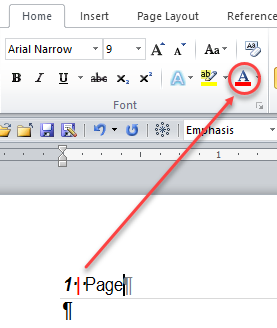

    • #1582636
      It is text. Select it as if it were the letter “l.”
      45864-00-deleteme-1

    • #1582694
      I had no trouble selecting it. I place the insertion point before it. I hold down the shift key and press the right-arrow key. It is selected.
      45872-00-deleteme-1

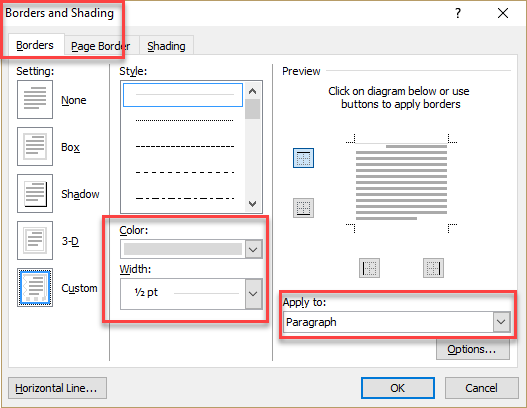

    • #1582721
      Hi Charles,
      I see the confusion I caused. The accent bar I was referring to is the horizontal line above the page number. It appears a light grey on my document. I would like to be able to change that to the light green that I made the page numbers.
      Rick
    • #1582745
      That is a paragraph border. You can change it once you have your insertion point in the page number line.
      45876-00-deleteme-1
