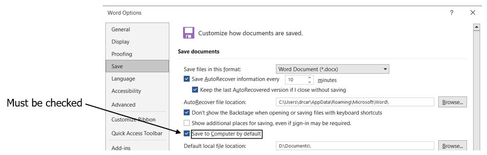

      Have you tried changing the default in Word Options? Make sure Word is set to Save on this computer as shown in the image below. Then use the Browse button to go to the location you want.
      If you have already done this and Word will still not let you access that folder, try another location and see if Word will accept that.
      If not, then I suggest a repair of Office.
      Word-Options
      HTH, Dana:))

        Yes. I have ensured that the setting for Save to Local is set. Didn’t help. I also set up a new folder under Documents and copied the contents of the original folder to it. Still unable to select that folder in Outlook Data Files. It keeps adding OneDrive to the path.

        6. Went to Word\File\Options\Save.
        7. Ensured Save to Computer by Default was checked.
        8. Default location showed C:\Users\Don & Lulu\OneDrive\Documents\.
        9. Clicked Browse.
        10. Modify Location box displayed.
        11. Navigated to This PC\Documents\Word Files II.
        12. Folder name shows Word Files II.
        13. Clicked OK.
        14. Returned to Save Documents screen.
        15. Default location NOT changed. Still has OneDrive in path.
        16. Cancelled.
