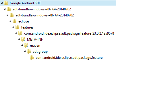

    I downloaded ADT-bundle-windows-x86_64-20140702.zip and extracted it with 7-zip. I tried to find the file to run it but could not get it to work. I now have a folder that I can not delete. I now have a folder that looks like this:
    38263-undelete-problem
    This is the error that I get when I try to delete it:
    38264-undelete-problem-fig-2
    Can anyone tell me how to delete this folder?

      You need to rename one / several of the top level folders to have nice short names, like “1” or “2”. Then the lower paths are not too long.
      • #1472763
        There were 80 folders all total with all of the sub folders. I renamed the first 9 and then I could delete them all.
        Thank you

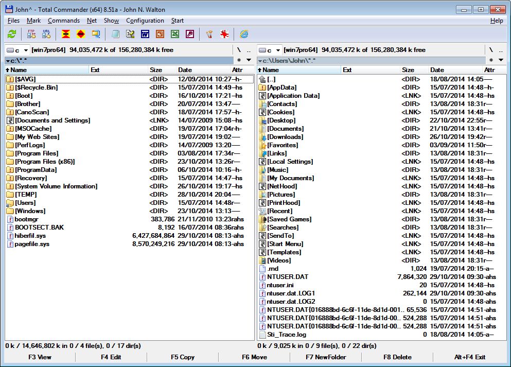

        I often run into this problem when working on restoring users’ files after a clean-install or new PC after having backed up the files from their old system. Most often the problem files are saved webpages, or music/video files. Often the upper-level folders cannot be renamed due to “file not found” errors, but if you “drill down” to the lowest-level folder you can delete the files in that folder then work back up through the folder “tree” deleting as you go.
        This was more of a problem with XP (e.g.: “C:Documents and Settings[user]My DocumentsMy Music” etc.) and is no doubt why Vista and later use shorter folder names (e.g.: “C:Users[user]Music” etc.). Note also that with XP the default location of the special “My Music”, “My Pictures”, and “My Video” folders was inside “My Documents”, but with Vista and later the “Music”, “Pictures”, and “Videos” folders are directly under the user’s folder.
        Don’t be misled by Vista and later displaying “My Documents”, “My Pictures”, etc., in Explorer windows. The actual folder names on disk do not include the “My “, they are simply “Documents”, “Pictures”, etc.
        Screenshot of “Total Commander” showing actual file/folder names with contents of C: in left pane, and contents of C:UsersJohn in right pane:
        38269-TC
