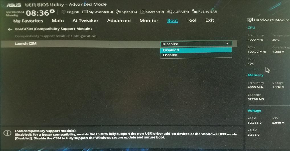

      If I understand you correctly, you are trying to set CSM (Compatibility Support Module) to “ON”. I agree with you, that is very strange that you can not enable it. I have a new Asus Prime Z790-V AX which is probably using the same UEFI BIOS, and I have no problem setting it to ON for compatibility mode or OFF  for Windows UEFI only. Just for a data point.
      20240930_083629
