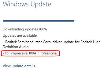

AskWoody MVPMarch 19, 2015 at 12:39 pm #1496026Quick update on the sound issue in build 10041.
I was still getting the repeated failed install of a Realtek HD driver in Windows update so I applied the workaround from post #12, restarted and ran Windows update again, this time the driver finally installed and a new icon popped up in the system tray.
browni

AskWoody MVPMarch 20, 2015 at 12:51 pm #1496218Update to post #19, just had it confirmed on the Insider forum that another Realtek driver was released today to fix another problem. Phew!
Jean, it probably installed Microsoft drivers by default and is now downloading the Realtek drivers which do a lot more. My screenshot in post #14 demonstrates this.
