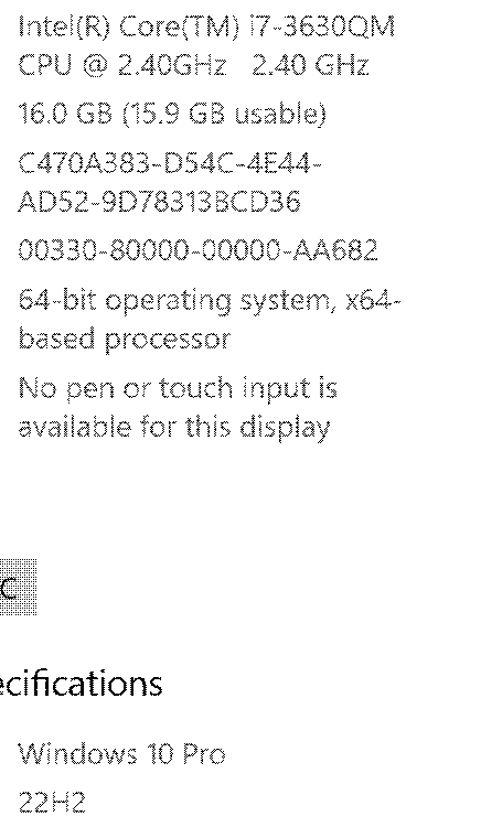

    I am getting the blue screen of death errors continually. Sometimes I reboot and can use the computer for a while but that is getting less and less often.  Recently I have to use Safe Mode to do anything.
    The blue screen error says, “IRQL not less or equal”.  I am running Win 10

    • #2583887
      Did you install any optional updates for Windows 10?
      That error typically means that there is a hardware problem with your computer – faulty memory sticks, or something on the motherboard.  How savvy are you with computers? Can you open it up and test out removing one of the memory sticks?
    • #2583896
      Thanks for the quick reply Susan.  Yes,  I have been inside all of my computers and added memory or SSD drives etc.    I think I did install some optional updates at one time or another.  Can you give me a little more on the testing process?  I have 16gb RAM and I think it is in two memory sticks.  This is a laptop so it is a little more work but I have been in there before a while ago.  I seem to recall a program that could test the memory??
      Roger
