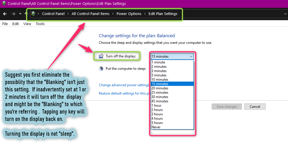

      When you say “blanking” while connected to HDMI are you referring to the monitor going into standby mode, but the power light remains lit? Like when your computer is shut down, but the monitor is still powered.
      What are your Windows power & sleep settings for the display? Are you using an integrated graphics adapter, or an add-on GPU?

        All settings are set to maximum and never sleep.

      blanking is a long-used IT term and has absolutely nothing to do with the power setting you’re referring to. blanking is referred to as a loss of power signal between the system, term has been used by microsoft, ibm, dell, hp for generations. please remove the power plans and other settings from your mind. this is all gone over. if it were a power management setting it would have been discovered. thanks though.
