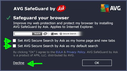

AskWoody_MVPJanuary 27, 2016 at 4:16 am #1549130Further to my #13 post I have run the newer “AVG_Antivirus_Free_x64_693.exe” and “AVG_Antivirus_Free_x86_694.exe” installers on my workbench PCs with the following insights.
In neither case did the installer attempt to install “ZEN” BUT (see below).
After you run the installer (either 32bit or 64bit) the first screen you see should be as in this screenshot:
Do not click the large “Continue” button (red arrow), rather click the small “Custom installation” (green arrow” link just below the “Continue” button.
In the next dialog click on the “Basic protection” option button to select it (green arrow).
AVG2016 should then install over your previous version of AVG (free).After the installation has completed you might see a pop-up in the notification area as below:
I recommend you should un-tick both checkboxes then click the “Decline” link (green arrows) rather than the somewhat more attractive and larger “OK” button. Believe me you don’t want anything from ask.com on your computer.
Once the installation is finished you should see:
Ohterwise you might have to reboot your computer to allow AVG to properly upgrade itself.
