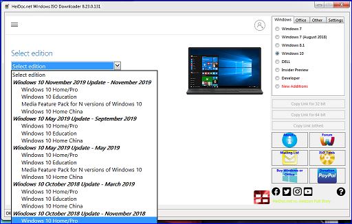

        • #2023031
          Which download of Windows 10 did you select in the Heidoc options dropdown?
          Heidoc-downloads-Win10
          • #2023059
            I could not get the executable to work and ended up at the web site, where I downloaded the MediaCreationTool1809.exe . Then the process is similar to AveYo’s MediaCreationTool .
            I did a SHA256 hash of the two MediaCreationTool’s and the hashes are the same. Still I went to try the upgrade, to confirm the Windows.iso was 1909.
