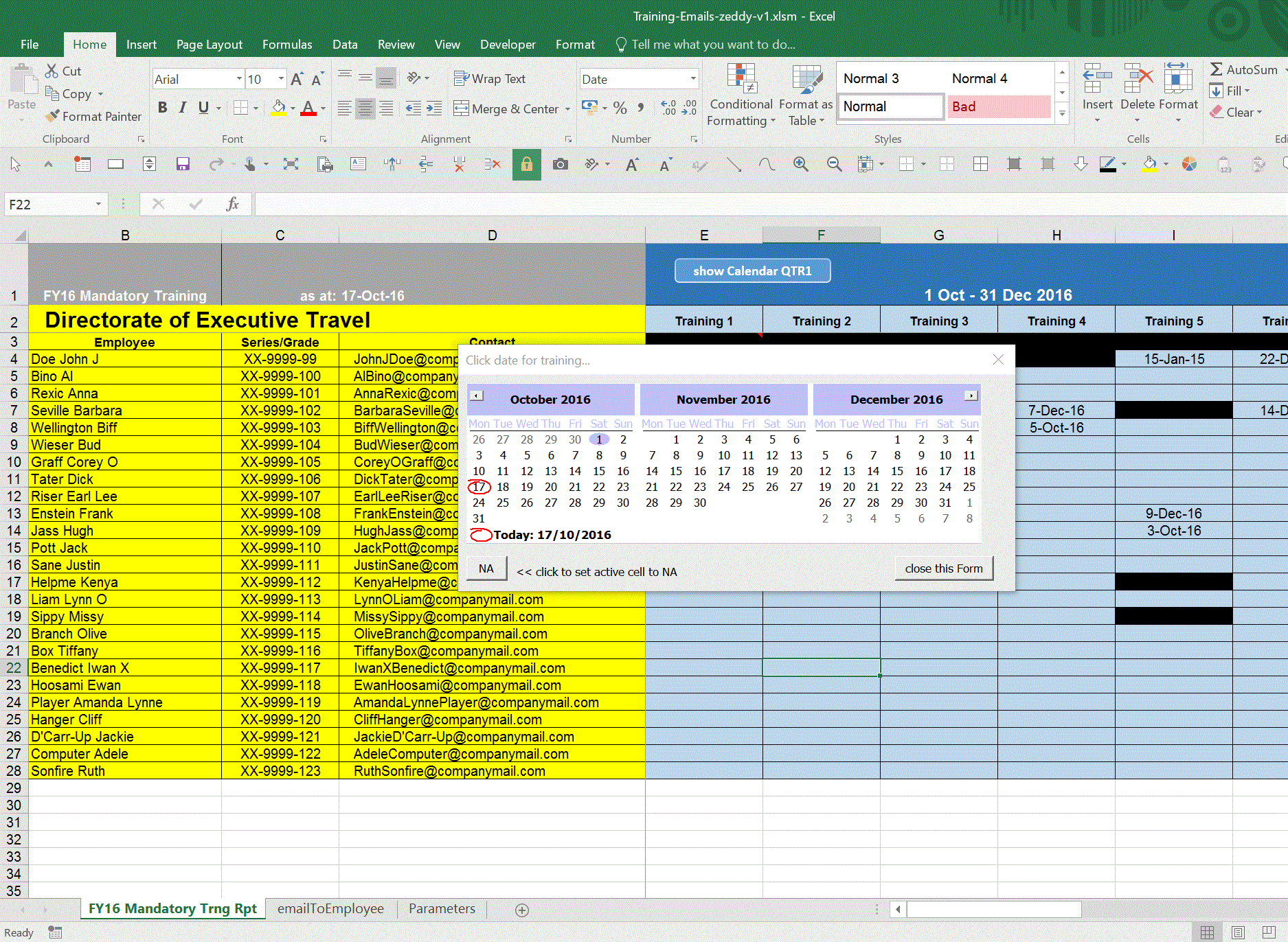

          I was looking for a solution to a similar problem and stumbled on to this. This is 90% of what I need, but I’m having trouble making it fit my application. I’m trying to poll a massive shared excel spreadsheet row by row for missing data in one particular cell (it would be blank), and then send the previous 6 cells in that row along with the row headers to an email address in the cell 7 rows previous. It’s reminders for sites that haven’t reported back corrective action on incidents, the previous rows are the demographics of the incident and the polled cell is where the corrective action SHOULD be. Basically, we’re spending a lot of time clicking, copying, and pasting information into an email template, then pulling the email address based on the site ID and hitting send.
          I’m good with Excel, so I can shoehorn the data to make it fit whatever template I might find, but I just can’t figure out exactly how to fix the macro. One challenge is that I think I need more variables to pull the data into the email, I was reading in the Help that you have to declare variables, and I’m not sure where to do it. And instead of testing the cell to see if it matches another, I just want to see if it’s blank. zHours = 0 and zHour = “” both seem to not work. I suppose I could just filter out anything that isn’t blank before I run the macro and skip that whole bit entirely…
          I attached some dummy data formatted the way mine is currently. In short, for each row, if H is blank, I want to send B through H (and the headers) to A. I imagine it would be pretty easy for anyone who knows this stuff to modify the posted macro to get something to work. Failing that, any guidance on how to proceed would save me a lot of additional research. I used to program in QBASIC and C++ years ago, so I’m not totally hopeless, I just don’t know enough about the particulars of VB. Thanks in advance for any help!
      • #1583951

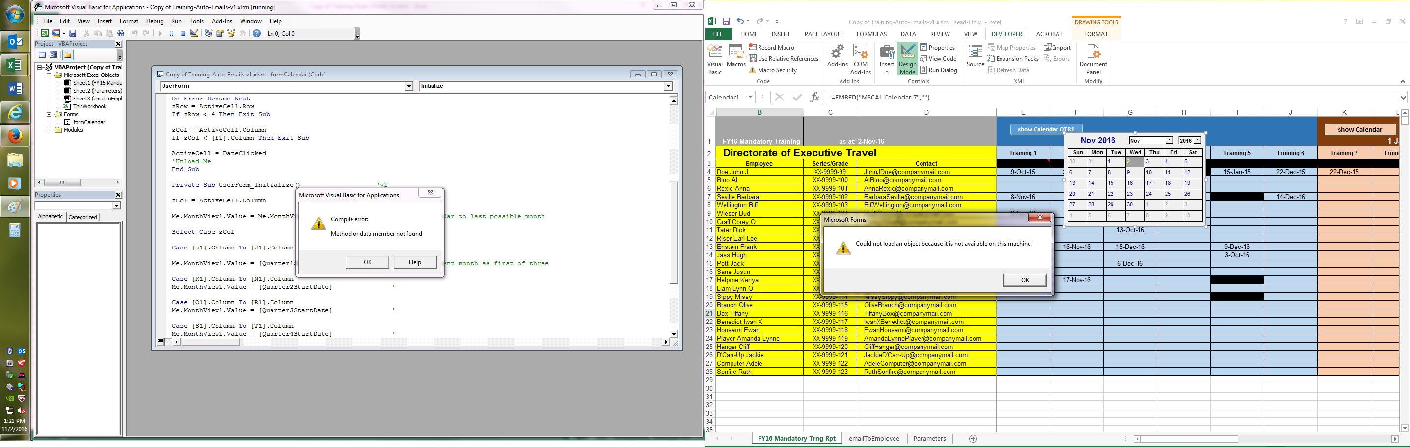

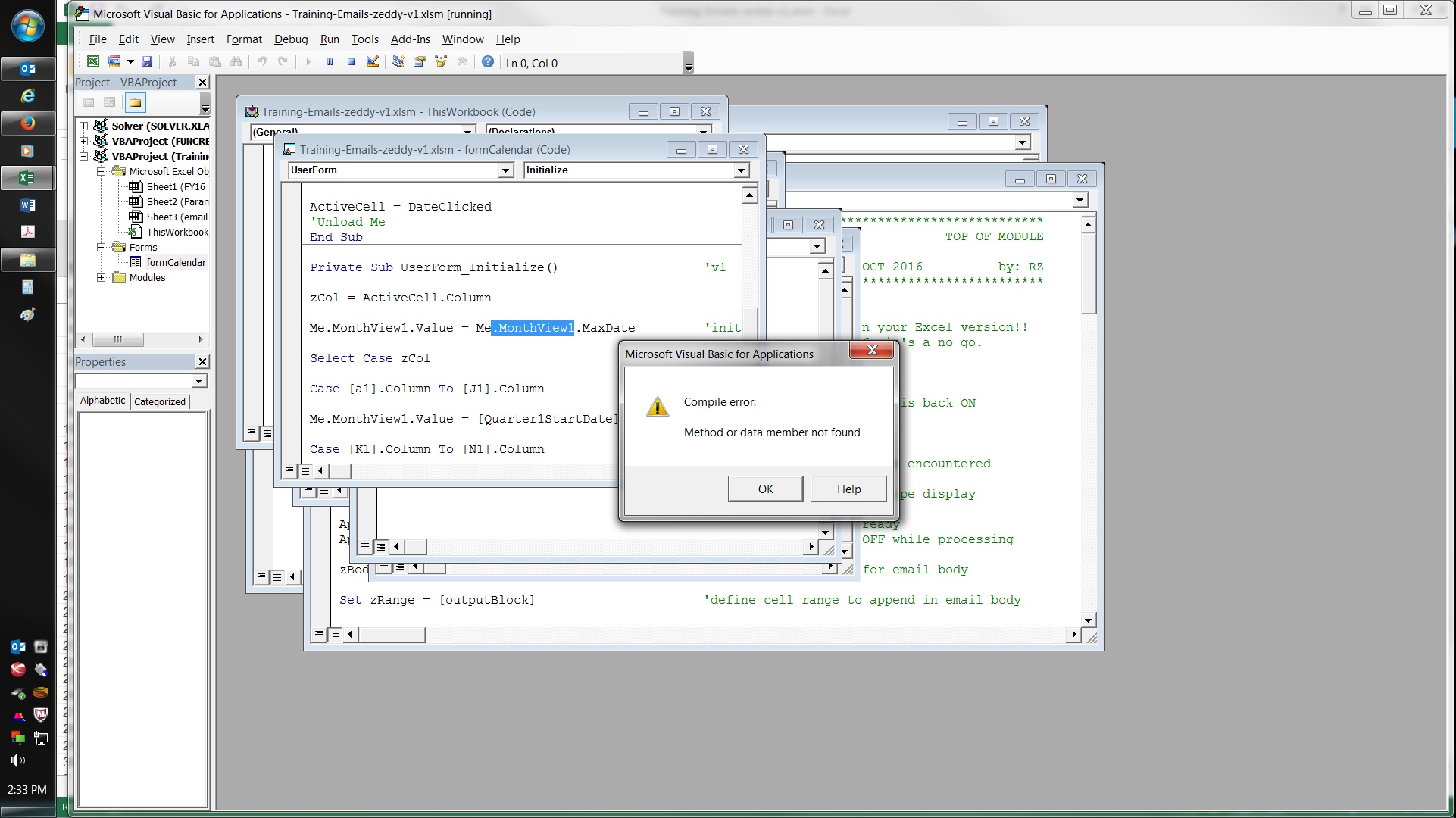

    • #1498344
      When you send an .xlsX file you automatically strip out all macros. Try sending your file with the macros.
      • #1498394
        That might help, right? Sorry…
        I played with this a little during some down time and I think I have it about ready, but there’s one gremlin I can’t figure out. When I set it to .Display the emails, I can see it cycling through all of the emails. But when I set it to .Send the emails, it only sends the first one. Any idea how to get past this? Do I need to set a delay so Outlook can keep up? If I can get that done, I’m gold.
        Thanks for everything.
        (Important Note: I haven’t gone through the trouble of updating all the comments, or even the name of the original Macro. I made my changes to the “sendUnexcusedEmails” macro. The only real change was the test of whether the macro would send the email from a greater-than-a-reference-cell to an equal-to-a-reference-cell (a blank one) statement. The rest is just pulling different cells and the body of the email. I didn’t want to delete or change any of the other stuff for fear it would stop working.)
        • #1498435
          GOT IT!
          The problem is actually with the original macro. Minor fix, instead of putting the line of code “Set OutMail = OutApp.CreateItem(0)” towards the beginning, it needs to be inside the iterative process. I put it right after all the “strbody = strbody &…” definitions. Works like a charm. I think that if it’s outside that process, it only creates one email and sends it, or continues to modify it in the case of the “.display” function. Inside the process, it creates a new email for each cell it encounters. Just a warning, at least for my purposes, that may mean it pops out hundred of emails at once, so if you’re “.display”ing them, it may crash you. For the example attached, there’s only 9 emails generated, not as big a deal. But unlike the original, it doesn’t just change around the information on one email when you display it, it generates 9 separate emails.
          I’ve attached my fixed template. I still didn’t clean up the comments, sorry. I’ve spent enough time on this today. Thanks again to the OP and to all the contributors, this is going to free up a lot of time for my people. Cheers!

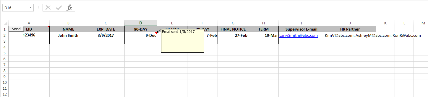

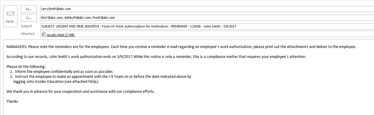

          Hi
          I have an updated sample file which uses the email address from column [A] as in your previous data sample.
          This new version uses an Excel Table.
          (To create a Table, start with your initial sample, select a cell in the header, and press Ctrl-L)
          I think a Table would be more useful for you.
          This update will also log when an email is sent (an idea that Maud suggested previously).
          I am away for the weekend.
          Any questions, post back.
          zeddy

              Hi steamfunk
              Apologies for the delay! I had to cut short my trip to the Caribbean.
              Back at the hospital next day after landing. My surgeons know me inside and out. Especially inside.
              Anyway, back to the Training Emailer tool..
              I have attached first version for you to look at.
              I have tested this OK on my system, with Outlook 2016 and Excel 2016.
              It should work with Excel 2010 and Excel 2007, as long as your Outlook version IS NOT newer than your Excel version.
              Sheet [FY16 Mandatory Trng Rpt]
              I have added some dummy records for testing the emailing.
              I hope you liked my sample names. This was the best bit for me.
              To enter sample dates, I included a Form to display a Quarterly Calendar for each of the Training Quarters. Click any of the [show Calendar..] buttons in row1 to display the Form.
              This will allow you to quickly enter a date into the currently selected cell.
              If you want to mark the cell as NA, click the [NA] button on the Calendar Form (bottom-left-corner)
              The Calendar Form is displayed as a ‘modeless’ Form, which means it will stay displayed until you decide to close it. This allows you to select cells and click required dates. You can ‘move’ the Calendar Form by dragging it with the mouse. You close the Calendar Form by clicking the button [close this Form] (bottom-right-corner).
              Sheet [emailToEmployee]
              In cell [B3], enter your own email address for testing the tool. This will send the test emails to yourself.
              When you are happy with your tests, just copy cell [E3] to cell [B3] to have the emails sent to the Employee’s email address.
              Before you begin:
              Use the clicker [1] to show the manual selection of Employee records. Note how the data changes in rows 11 to 16
              Use the clicker [2] to select the Training Quarter. Note how the Subject line changes in cell [B4] as you use this clicker.
              NOTE:
              I have not done the sheet [emailToSupervisor] yet.
              Please let me know how you get on.
              zeddy

              Greetings:
              I am working with Outlook and Excel 2013; I have attached screenshots of the two error messages that I got, both pertaining to the Quarterly Calendar.
              Other than that it worked perfectly! YOU ARE THE MAN!!! ;););););););)

            • #1581708
              Hi Steamfunk
              This is what it should look like:
              45797-training-1
              OK, so I need to check what you have to do to get that Calendar Control available on your system.
              It is generally available when you have Access installed, but Microsoft has made it more awkward lately.
              I have lots of versions installed on my system, so sometimes I forget about the Calendar Control issue.
              Let me check it out tomorrow, and I’ll post back.

              It would be just my luck that I have MS Office 2013 on a Windows 7 64-bit system…:(
            • #1581907
              Hi steamfunk
              ..all is not lost, as you can use the MSCOMCT2.OCX on a Windows 7 64-bit system!
              Its the Office-64bit that is tricky.
              Your Office 2013 is almost definitely Office 2013 32-bit.
              You can check this by selecting File>Account and then clicking the ‘About Excel’
              zeddy
            • #1582029
              Waiting on IT to approve downloading the MSCOMCT2.OCX… :-/

              I’m sorry I have been away; my hubby had emergency hernia surgery, which nearly killed him…So I have been at home for a bit.
              So, let’s get back on track… the IT Dept gave me a huge thumbs down on the download…(not surprised…they are software hoarders…lol); I moved offices so I am on a new-to-me PC…with the same old network tomfoolery (again, not surprised).
              MS Office here is 32 bit; however I did see Calendar Controls 12.0 in the More Controls…so I tried to play with it and the calendar is still a problem. As much as I could use the calendar function, can I just do without it and manually enter dates?
              Looking forward to hearing from you again soon and I pray all is well with you!

              So, in the last attached file, I was trying to re-create a three-month-calendar view, using three copies of the ‘single-month-calendar’ on the Form.
              This is more complicated than using just a single-month-calendar on a Form.
              I just wanted to see if it could be done.
              When this 3-month Form is displayed, you can drag it to a convenient location on your display.
              It will stay on the screen until you dismiss it (either by clicking the top-right-corner [X] or by clicking the [close this Form] button).
              If you select a cell, clicking on a date in any of the ‘month-calendars’ on the 3-month-Form will put that date into that selected cell.
              If you move the cellpointer to another cell that has a date in it, that date will be highlighted in the appropriate month on the Form (provided the cell’s date is within the 3-month Quarter of the displayed Form).
              This uses the sheet-code selection-change event.
              To view that code, right-click on the sheet-tab-name, and select ‘View code’.
              The Form also has a button to set a cell to NA (this will show as a black cell via conditional-formatting)

              Hi Uncle Charlie
              So, welcome to the Lounge (I should’ve said that after your first post).
              In the attached file, I’ve added some stuff that might make life easier.
              I’ve included a ‘datestamp’ that shows when emails were sent.
              This is a feature that Maud taught me (it helps prevent sending too many duplicated emails otherwise).
              I used two sheets to allow for setup of different email body text etc etc.
              To test this file, you could put your own email address in the vba code for To:
              ..and also comment out the code for the .CC staff email when testing.
              You need to have Outlook as your mailing system.
              And, as I have discovered during testing, your Outlook version must NOT be newer than the Excel version you are using!
              have a look at this, and post back for any questions etc etc.
              zeddy

      Kyle,
      Attached is your modified spreadsheet that will send emails as you requested based on a time period between today’s date and the expiration date. The code will cycle through the list of names (unlimited number). The emails will be sent to the supervisor and cc’d to the HR partners. A return receipt will be generted when the supervisor views the email. A comment is placed in the appropriate column D-G time stamping the date that the email was sent. The comment also acts as an inhibitor to resend an email that was already sent. If you would like to resend the email then just delete the comment.
      The email will be generated and displayed for 3 seconds allowing you to have a quick view then is automatically sent. It is assumed your email client is Outlook and it is open at the time you run the code.
      HTH,
      Maud
      generated email:
      46360-Kyle1
      Comment added as a time stamp:
      46361-Kyle2

        Kyle,
        HTH,
        Maud
        generated email:
        46360-Kyle1
        46361-Kyle2
        you are a life saver! you have no idea how much time this will save!

        Thanks for the prompt reply, I have already tried that before but its still not working. Can you pls help??
        Also how to change to code – instead of mailenvelope I want to use outlook for sending mails.
        • #1590668
          Hi Avinash
          What version of Excel and Outlook are you using?
          Do you have Outlook running when you try the Excel SS Dispatch file?
          (Note: The MailEnvelope method will send the email using Outlook)
          zeddy
          • #1590673
            Hi Zeddy,
            I am using office 2016, I have tried with both outlook open and closed.
            When I run the macro, I only get the glimpse. Rest no idea whether mail was generated or not as I cannot see it in either outbox or in sent item.
