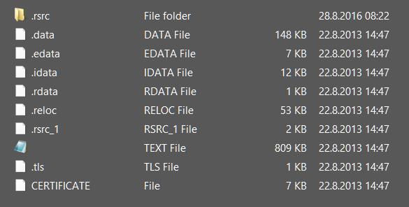

      I don’t know how to change the Internal HD Audio bus. Since it is part of Microsoft. The Device Manager update says it’s updated and uninstall also is not help. I decompressed Realtek driver I got from ASUS, using 7-Zip, but files I got out does not look like anything to be recognized as a driver.

      Assuming by installing manually, you mean in Device Driver, instead of selecting; ‘Search automatically for updated driver software’ using the other option; ‘Browse my computer…’
      So yeah! I don’t really know which file I am suppose to choose to install.. I mean there are all these files but I have to choose one of them? There must be more to it than just that…
