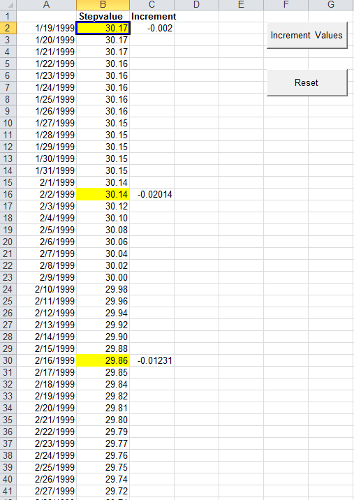

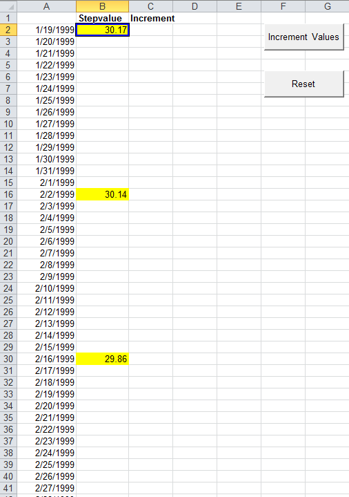

      Here is code that will do what I think you want. It will fill in incremented values between the points in column B (yellow highlight). The increment is calculated by the difference of two consecutive points divided by the number of dates spanned between them.
      HTH,
      Maud
      35054-stepvalues1 35055-Stepvalues2

        Hi Maudibe
        Where have you been – you have been missed.
        I like your solution.
        Nice work.
        I added a chart to your solution.
        So I could see what’s going on.
        Yeah, I know it wasn’t asked for.
        zeddy

      Zeddy,
      Thanks, tweaks are cool. Nice touch with the graph!
      JP,
      you are more than welcome. Forgot to mention that you can add as many sections as to the number of rows the sheet will hold. The code will adjust. Just remember that the final section must have a trailing point in column B or that section will be ignored. If you choose to adapt the code in your project then:
      1. Change the 2 in the line lastrow = ActiveSheet.Cells(Rows.Count, 2).End(xlUp).Row [/COLOR]to the column that has the points.
      2. Change b2 in the code line [b2].Select [/COLOR]to the cell of the first point. There are 2 instances.
      3. Add the code to a standard module
      Maud
