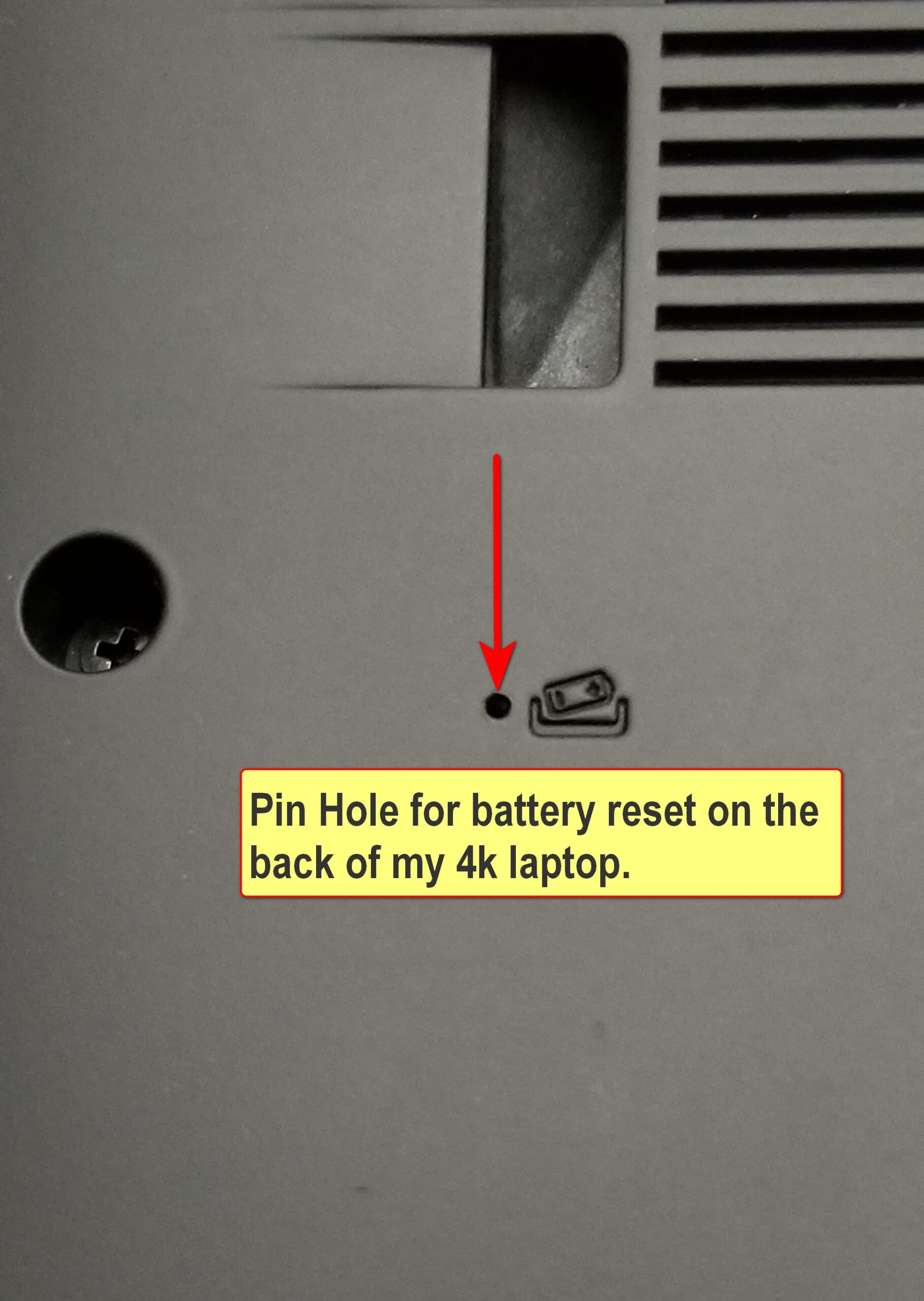

        I’m assuming your wife’s computer is a laptop.
        This is a long shot but you could try resetting the battery.  Oddly enough I’ve fixed vexing laptop issues with a battery reset even though I was NOT running on the battery. Gone are the days of removable batteries and newer machines might not have a battery reset method.  Check your user guide.
        That said….
        Power off.  Turn the laptop over and look for a pin hole for battery reset.
        Pin-Hole
        Straighten out a large paper clip and gently slide the wire into the pin hole.  Don’t force anything. When all the way in, apply a LITTLE more pressure and you should hear a tiny click and feel a slight spring action.  Hold it for 20 seconds to let capacitors discharge.
