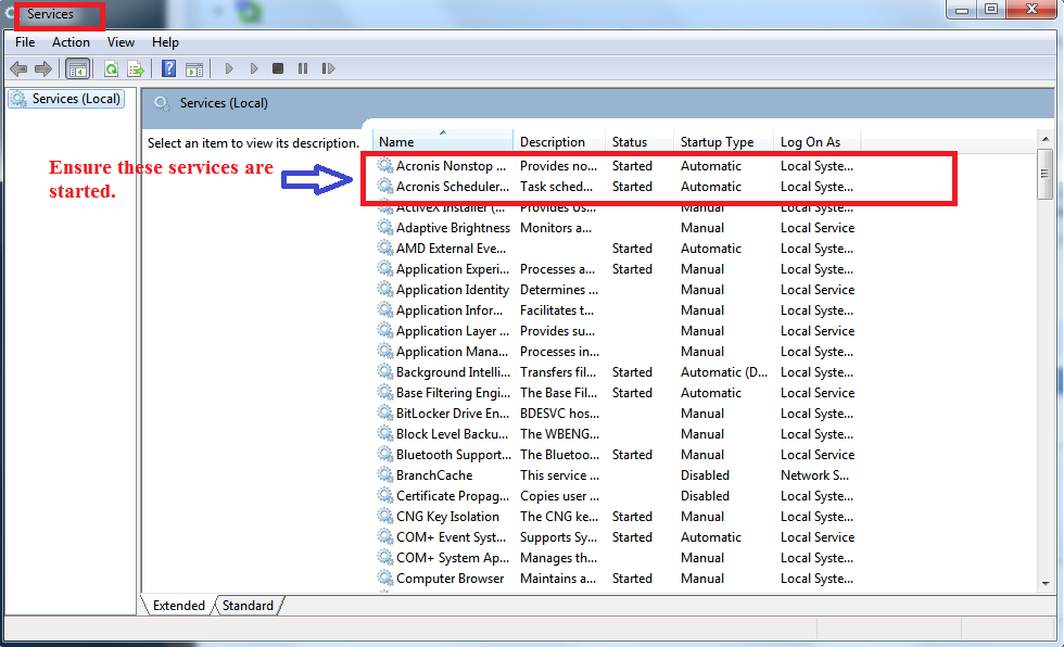

        I have a somewhat similar, not exactly the same, problem with Acronis True Image Home 2010. I try to start a full backup to my external USB hard drive (WD My Book 3.0, 1TB) and very quickly get a screen message “I/O file error” with no further explanation and no opportunity to “Ignore”. BTW, I have done backups to this drive in the past.
        If anyone can give me any suggestions how to get out of this mess, I would surely appreciate it! Trying to communicate with Acronis is all but an impossible dream- I can’t even find the “Live Chat” option on their website anymore.
        • #1263720
          I would double check to ensure the Acronis Services are started in Automatic. Type Services in Search Box.
          27156-AcronisServices
