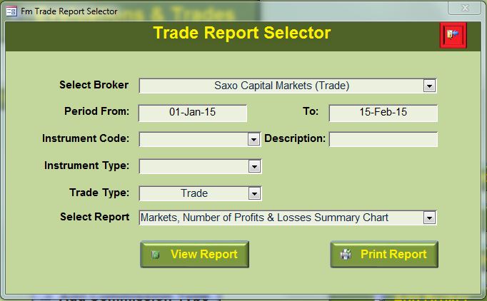

        The Query that forms to basis of the Report is a saved Query that when run takes filter parameters from the Report Selector Form that calls it.
        The Report Selector Form that provides the filter parameters:

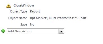

          I’ve inserted the following Macro in the Report “On Close” event:
          39601-20150227-Report-Close-Macro
          Only now the issue has resurfaced and I can’t work out what I’ve changed to make it resurface
          :confused:
