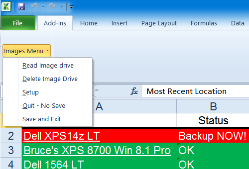

      It’s always been my practice to create all menus in code. That way every time the application is used the menu is recreated and any thing the user might be doing is of no consequence. It’s all about control of the operating environment which IMHO takes a lot of the load off of support personnel.
      FWIW, here’s sample copy of the menu code I use in Excel (It’s VBA so it should work in any Office App). Of course in Access I usually use a Switchboard and completely hide the user interface, as I said it’s all about control :evilgrin:
      Code:

      What the above produces:
      44053-ExcelMenu
      BTW: the above code works in Office 2003-2010, last version I have, the only difference is in 2007+ it shows up on the Add-ins tab vs it’s own menu item.
