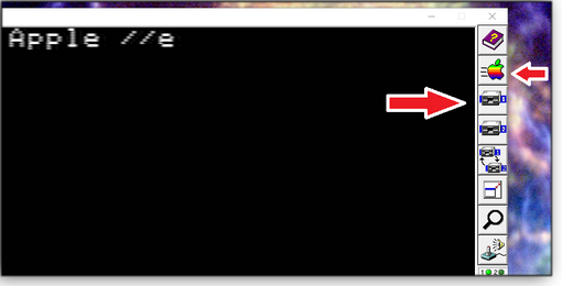

Ready to go? Let’s fire it up!With the ZIP files extracted, click the Applewin.exe file. You’ll see the opening screen shown in Figure 1.

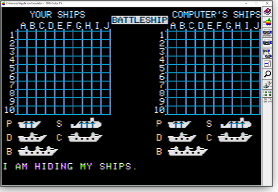

Figure 1. AppleWin’s startup screen. Note the tool-bar options along the right edge.Next, we insert a virtual disk by clicking one of the “drives” on the right edge and choosing a .DSK file from the Apple II Disk Images folder. (Note: First, you’ll have to extract the apple-ii-disk-collection.zip file that’s included in the downloaded ZIP file. The apps you’ll be loading are in the extracted APPLE-II-DISK-IMAGES folder.) Next, click the Apple icon to reboot.

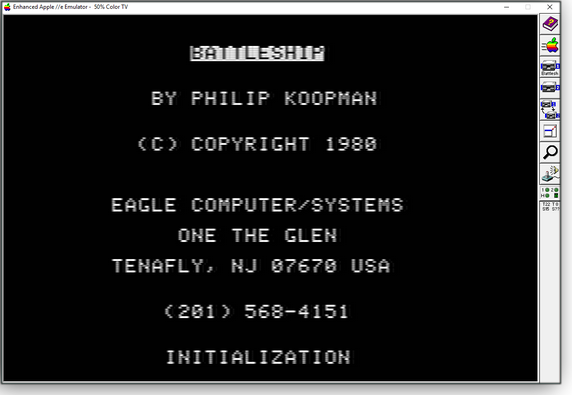

Figure 2.I’m going to select Battleship because … well … it’s Battleship!
Figure 3.

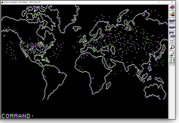

Figure 4.AppleWin includes all sorts of options for bridging Apple II–era hardware and software with today’s Windows-and-mouse technology. You can, for example, map your keyboard to emulate the joystick those old games expect — and you don’t have.

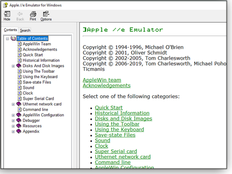

To get the most from the emulator’s options, check out the built-in manual (see Figure 5), accessed by pressing the help button at the top-right corner of the AppleWin window. (If your kids want to play with the emulator, you might have to explain the concept of “manuals” to them.) Use the Quick Start section to jump-start your Apple II sessions. I also recommend perusing the Historical Information section — it’s an interesting read.
Figure 5. AppleWin’s help window is an excellent resource for getting the most from the emulator.The tool bar on the right side of the emulator has all the tools to control your Apple. Here’s what they do:

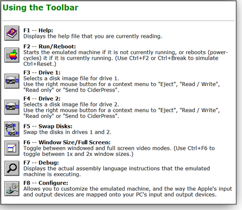

Figure 6. This cheat sheet for the AppleWin toolbar can be found in the help menus.The apple-ii-disk-collection.zip file has an amazing number of programs and games. It took me a couple of hours just to do a quick review of what’s included. You might have to extend your Memorial Day holiday to check them all out thoroughly. Take Tuesday and Wednesday off work, too!
